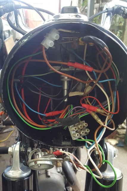

Wiring inside the head lamp, all a bit of a mess, connectors with nothing conned to them, wires going nowhere and the flasher unit just loose in the shell.
Eppo
If there is only such a mess in the head lamp I would go to label all known wiring cables to what the schematic show and then disconnect all and clean up the wiring in the head lamp with proper connectors.
What then left over can go to trash.
And for the so called "chocolate block" connector it looks like the wiring to the front beam lamp socket was too short and has been improved by adding some shorter pieces.

And while you are at it...once the inside is almost empty anyway, take a brush and paint it white...nothing fancy, any paint will do, but it will help along matters a lot in the future...
And the best way you can proceed is
1. old wires out
2. paint the lamp housing inside white
3. install new wiring harness (£53.53)
(without this prince of darkness connectors)

Do NOT take the switchboard out of the lamp if not absolutely necessary. The keyhole assembly will fly all around your workshop...and the metal tabs for fastening the board back break easily. Better take off the lamp if you need a better look. Or use a headlamp and kneel down...Or use small mirror.
But to connect a new harness, take of the lamp, rip out all old wires, connect new harness proper colors to prober terminals following the instructions/wiring diagram , put the lamp back to the fork, and work from there backwards to the battery (with branches off to horn, generator, regulator and battery case
