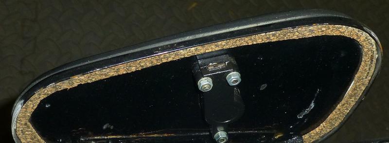

I had the same problem with the door rattling. I cut out the outline of the door from a piece of 3mm cork sheet
Then cut out the centre of the oval as shown in the photo and glued the 'gasket' to the door.
It is not original but the door does not rattle or leak now!
