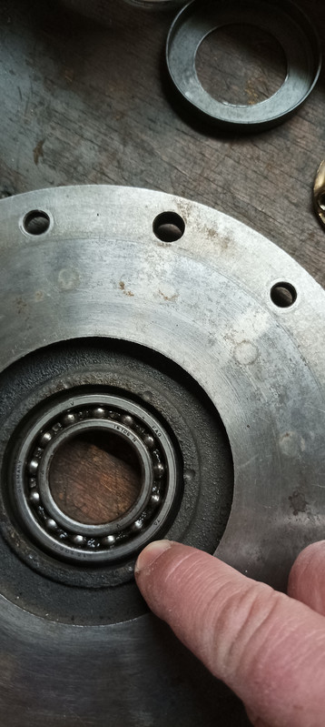

Hello,
I have a question.
The clutch bearing for a R35 is a 16006.
But it's smaller than the place to put in.
The assembly looks original ...
Is this normal ?
Here is a picture :
CLAUDE
cwf
Hello, it looks from this illustration that there is a ring to hold the bearing and the pressed steel disc fits on top.
Charlie.
CLAUDE
Hello Charlie.
Thank you, I must make one like this.
