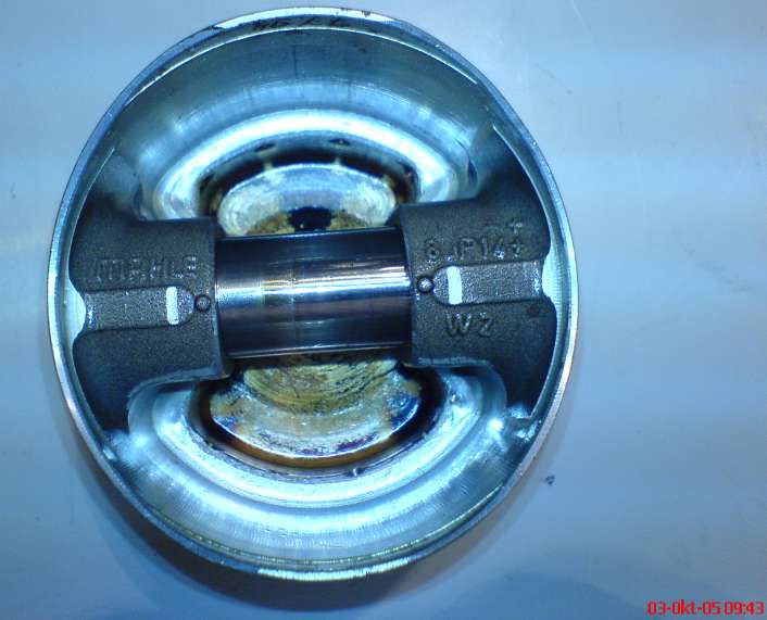

I added a few grams of lead into the inside of the oil slinger and polished the piston rod and crank webs around the crank pin. I am now at 51.5%.
I am afraid to take anything off the piston as I know little about where the stress points are.
Would taking weight off the flywheel be safe ??? or is it too far out of the line of force?
Granet
Hi "Granet"   ;),
adding some gramms of lead in the slinger reservoir is a nice idea - even i would not do it because it is not symmetrical to the crankpin. And you are right: taking off material from the piston is something for the specialists - it was done on my 78mm piston by the "piston-guru" Wahl :
They did it mainly at the inside area of the piston skirt - it works fine till now, circa 15000 km.
