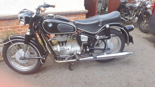

I have just recently acquired a 1964 R27, it has been in storage for some time so will need a little work before returning to the road.
The motorcycle in the background is a NSU 251 OSL

Hello John.
Welcome to our forum and congrats for acquiring that bike...do you happen to know anything about the bike's history apart from been in storage?

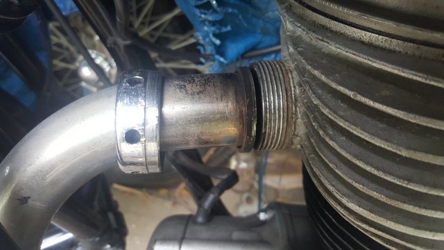

Monday I went for my first ride on the machine only for the exhaust ring to fall off around 100m from home. Walked back home to get a large pair of grips. Fell off again before I got home again, but I had the grips with me so no real problem.
Should there be a gasket/sealing ring here? If so it was lost somewhere along the road, however I plan to put one anyway so I have ordered  2 (one spare) and the proper "C" spanner to do the ring up

:kopfhau: Yes, there would be a gasket (copper) under normal circumstances...
Make sure to tighten perferably if the cylinder head is cold and don't overdo it...once that thread is ruined it can be restored (at least on the continent), but it takes some time and a fair amount of money....

Yes, a seal is intended there. Concerning the C-Spanner I'd like to point out, that improper match often is the root-cause for damaged thread on the exhaust stub.
That happens, when the gudgeon is slightly too long. It rides on the ridges of the thread then and flattens them down. I'd check that and grind off the gudgeon a bit,
if necessary. Prevents you from having to spend ~ 100 bucks for the thread repair in the future.  ;)
It's quite common for the 250 cc beemers to shake off the sleeve nut. The most frequent root-cause (apart from damaged threads and missing seal )
is improper exhaust mounting. Consider the R27-engine is completely rubber mounted, thus the exhaust has to follow any oscillation and must be able to do so.
Therefore you have 1.st the lower pipe-holder, has to be attached to the studs, which also connects the gearbox to the engine. This holder must not be fixed to the
frame by no means ! ( Often observed ) At 2nd there is the rear muffler-mount, consisting of kind of a silent-block, allowing also the muffler to move and swing.
In general it is recommended to start attaching the complete exhaust by the head with the sleeve nut. (all other connections loose or off )
Then see, where the pipe sits without any tension. Then you go ahead with the lower pipe mount, fixing it without forcing the pipe into any offset.
Use washers or whatever is required to tighten it without tension. Finish off with the muffler mount.
Doing so eliminates the risk for the sleeve nut to go "separate ways"
Alternative you could replace the sleeve nut by a finned nut (Sternmutter). You need another particular spanner then, or tighten it with a strap-wrench.
(one of my favourite "on the road"-tools.) Or else, there are finned nuts available to clamp over the plain sleeve nut.
Both provide more heat dissipation and are advisable. ( also an aluminum valve-cover gasket to involve valve covers in cooling surface. )

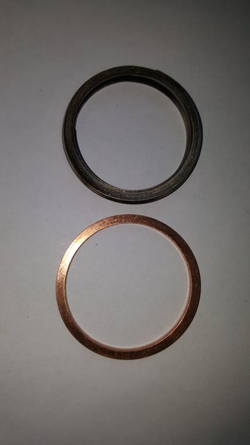

Sorted out my exhaust, only the first gasket I ordered although it worked it turned to be a little on the thick side (5.5mm) meant that the exhaust ring would no screw on as much as I would have wished.
The two different exhaust gaskets
The second attempt using a copper gasket at only 2mm thickness gave a better result.

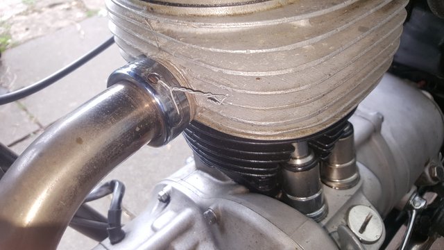

Exhaust back it place, "wired" in place.

it looks lke you took a flat gasket instead of a hollow one
